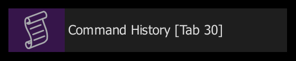

Command History [Tab 30]
Command histories are kept for each editing session, which begins when a new show file is created or when an existing show file is opened, merged, or imported.
Command History can be opened in a standalone tab from the Workspace Layout Menu or by using [Tab] & [3][0].

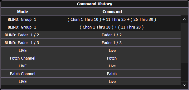

When [Undo] is used, the command history opens in the Central Information Area (CIA). It can also be opened with [Displays] <More Sk> {Cmd History}.
You can use a mouse, face panel arrow keys, or keyboard arrow keys to select one or more commands. When [Enter] is pressed, an advisory is posted. When [Enter] is pressed again, all highlighted commands will be undone and subsequently removed from the command history. When removing more than one command, a confirmation is required.
Pressing [Undo] [Undo] will scroll to the most recent undo-able command in the command history display. To undo the command, press [Enter].
From the Command Line
If there are any commands in the command line, pressing [Undo] once clears the command line. Once the command line is empty, pressing [Undo] will start the undo process.
When [Undo] is pressed from an empty command line, the command history display will open in the CIA and the most recent completed command is highlighted in gold. If you press [Enter], you will undo your last command. [Shift] & [Clear] can be used to clear the command line as well. If the most recent completed command is grayed out, it cannot be undone. Pressing [Undo] again will select the first command which can be undone.
